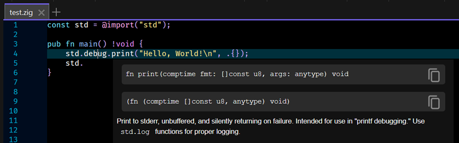

To test the configuration, create a simple test.zig file and fire off an autocomplete request:
lsp Zig
Shown below is an example of the functions signature feature.
signature zig
