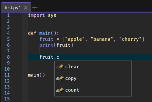

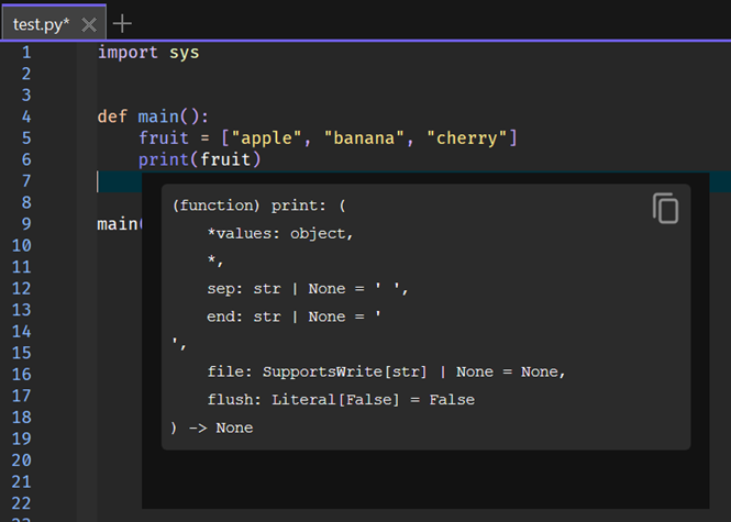

To test the configuration create a simple test.py file and fire off an autocomplete request:
Pyrefly python
Pyrefly python tip
