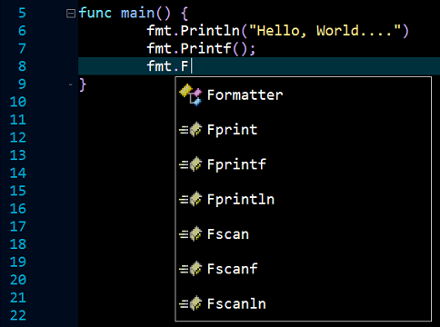

To test the configuration create a simple test.go file and fire off an auto-complete request:
lsp go

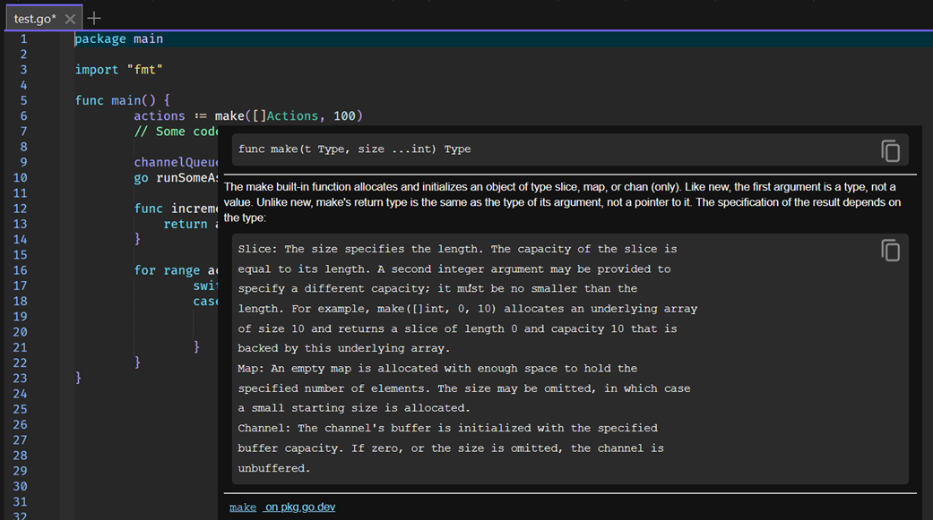

For example, the image below shows the result of a document hover.
lsp go hover
