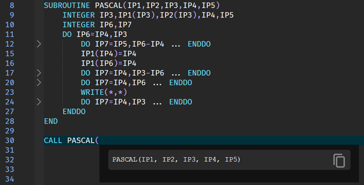

To test the configuration create a simple test.f90 file and fire off an autocomplete request:
lsp fortran
Shown below is an example of the function signatures autocomplete feature.

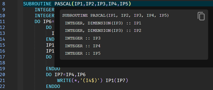

Fortran Language Server Tip
Fortran Language Server Hover
