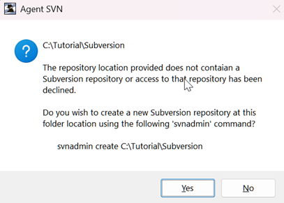

In this case the folder selected does not contain a Subversion repository, which means the following message will be displayed:
power-builder-setup
Answer Yes to this question so that Agent SVN creates a Subversion repository in that folder.

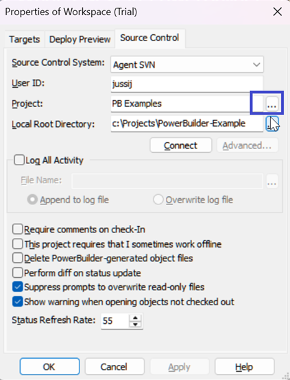

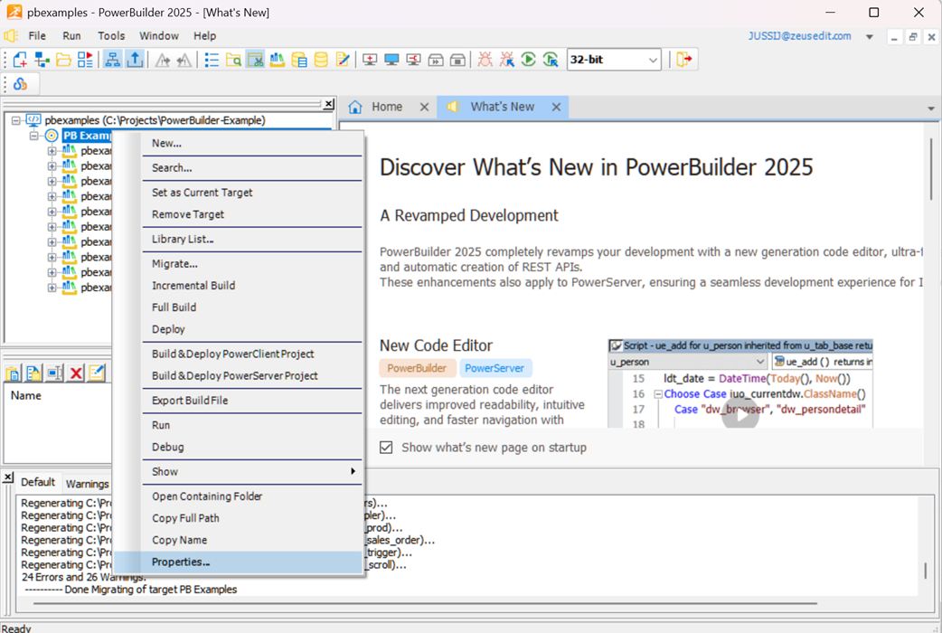

Step 3: Setup the Source Control for this Workspace
From within the PowerBuilder IDE use the Properties menu to bring up the PB Examples, Properties dialog as shown below:
power-builder-setup

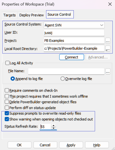

Setup Agent SVN as the Source Control System for this workspace, fill in the required connection details and also set the Status Refresh Rate to a high value as shown below:
power-builder-properties

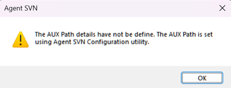

After applying these changes, if this following message is displayed check the setup details from step one to make sure Agent SVN is configured to point to an existing Subversion repository.

IMPORTANT NOTES:
Remember that Subversion is case sensitive, so make sure the case of the details entered matches the case of those same items as displayed in the Subversion repository.
Also, for simplicity the User ID entered should match your Windows User ID but Agent SVN will work fine if this is not the case.
But it is important to make sure the User ID entered matches the User ID that is used by Subversion itself otherwise the locking feature will not work.
If you are using the Agent SVN option to mark files as read only when not checked out make sure you also select the PowerBuilder option to not prompt when overwriting read only files.
To check this use TortoiseSVN to lock a file and see what User ID is displayed as having locked the file.
Make sure the Project entered matches the workspace name used in Step 3.
NOTE: If you want to bind the workspace to an existing project just leave the Project field blank but continue with the next step.
Make sure the Local Root Directory entered matches folder location of the workspace that was created in Step 3.

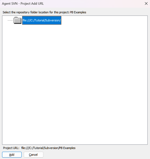

Step 4: Importing the Workspace
Use the button indicated to import the project into the Subversion Repository as shown below:
power-builder-bind
If this is a new project you will be presented with the confirmation request shown below:
power-builder-setup
This will result in the Subversion repository browsing folder, which lets you select the project repository import folder location as shown below:
power-builder-setup
NOTE: If the project name is left blank this button will bring up the project binding dialog instead.
Apply the changes and the workspace will now be bound to the Subversion repository.

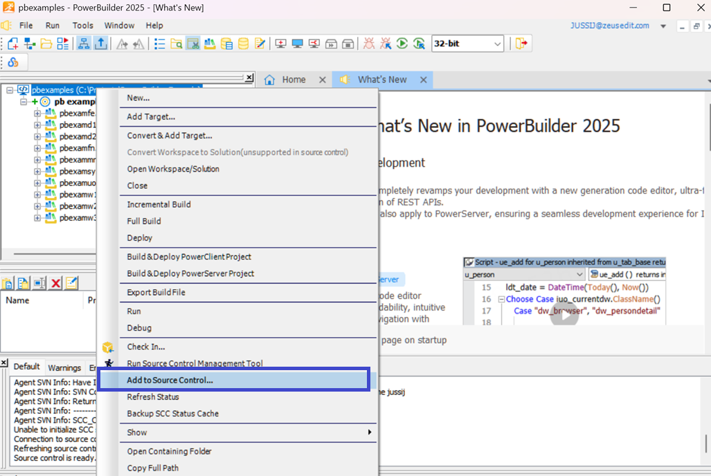

Step 5: Importing the Workspace Items
With the workspace now bound to the Subversion repository, use the Add to Source Control option to add the workspace items to the Subversion repository as shown below:
power-builder-import

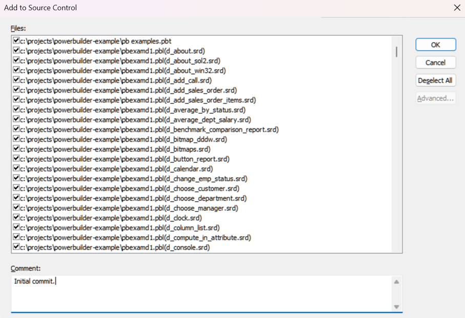

This will result in the following PowerBuilder import dialog:

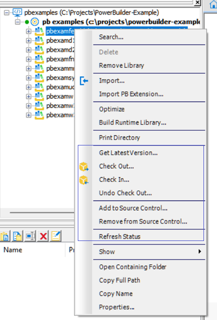

To access the source control from inside PowerBuilder use the popup menu as shown below:
power-builder-scc
IMPORTANT NOTE: If these source control menus are disabled, check the machine for duplicate copies of PowerBuilder pb*.dll files.

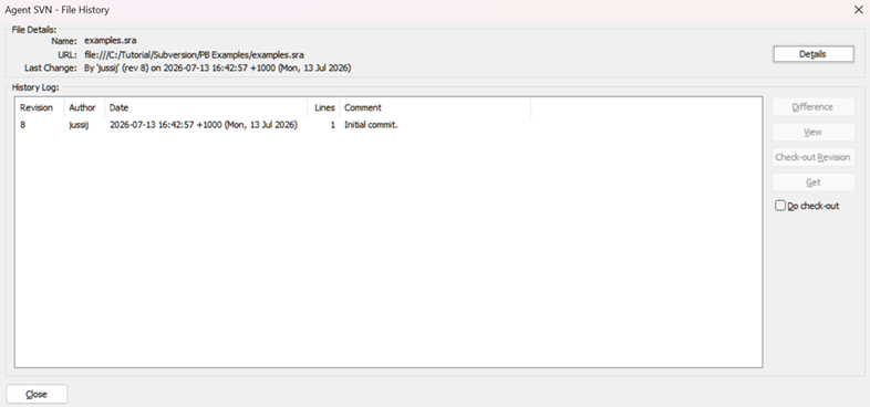

To check the bindings use the Show History menu to check on the source control history for the workspace as shown below:
power-builder-history

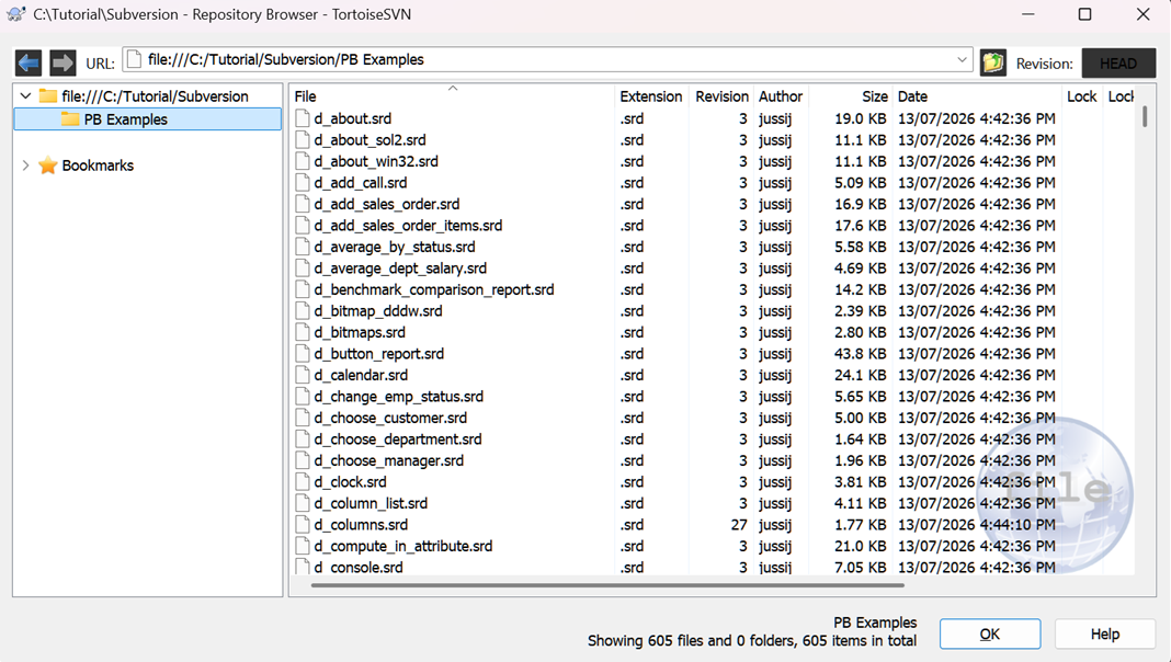

You can also use Tortoise SVN to example the contents of the Subversion repository as shown below:
With the workspace now fully configured, you can now use the check-out, check-in, file compare commands (or any of the other source control commands) to manage your workspace files.
