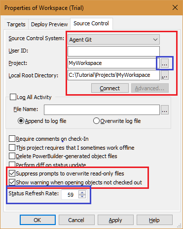

Setup Agent Git as the Source Control System for this workspace, fill in the required connection details and also set the Status Refresh Rate to a high value as shown below:
power-builder-properties
IMPORTANT NOTES:
If you are using the Agent Git option to mark files as read only when not checked out make sure you also select the PowerBuilder option to not prompt when overwriting read only files.
Make sure the Project entered matches the workspace name used in Step 3.
Make sure the Local Root Directory entered matches folder location of the workspace that was created in Step 3.

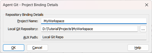

This will result in you being presented with the project binding dialog as shown below:
pb_binding
This dialog takes two inputs, a project name and a local folder location that contains the Git repository.

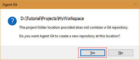

In this particular case, as this is a new project, hitting the Ok button will result in the following dialog:
pb_create_repo
The reason the dialog is displayed is because we are dealing with a new project and no Git repository exists for the project and as such the response should be Yes.
However, for the case where the project already has a Git repo the answer should be No and the path should then be modified to point to that existing Git repo.
Apply the changes and the workspace will now be bound to the Git repository.

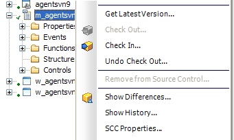

To access the source control from inside PowerBuilder use the popup menu as shown below:
power-builder-scc
IMPORTANT NOTE: If these source control menus are disabled, check the machine for duplicate copies of PowerBuilder pb*.dll files.
To check the bindings use the Show History menu to check on the source control history for the workspace as shown below:
power-builder-history
With the workspace now fully configured, you can now use the check-out, check-in, file compare commands (or any of the other source control commands) to manage your workspace files.
